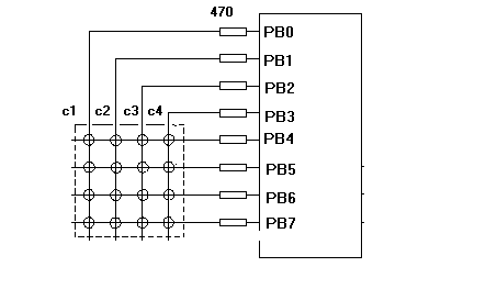

A schematic for PORTB is shown below
Note that the port pins can be used for other tasks as well. But you might need to set the port direction of those pins after you have used getkbd(). For example the LCD pins are set to output at the start of your program. A call to getkbd() would set the pins to input.
By setting DDR.x register you can set the pins to the proper state again.
As an alternative you can use CONFIG PIN or CONFIG PORT.
When no key is pressed 16 will be returned.
When using the 2 additional rows, 24 will be returned when no key is pressed.
On the STK200 this might not work since other hardware is connected too that interferes.
You can use the Lookup() function to convert the byte into another value. This because the GetKBD() function does not return the same value as the key pressed. It will depend on which keyboard you use.
Sometimes it can happen that it looks like a key is pressed while you do not press a key. This is caused by the scanning of the pins which happens at a very high frequency.
It will depend on the used keyboard. You can add series resistors with a value of 470-1K
