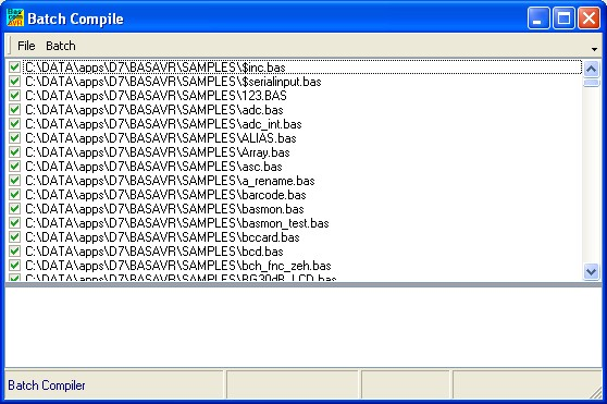

The following window is shown :
There are a number of menu options.

Batch Compile

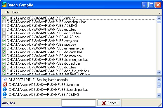

Compile the checked files. By default all files you added are checked. During compilation all files that were compiled without errors are unchecked.
This screen print shows that $inc.bas could not be compiled.
And that array.bas was not yet compiled.

All results are shown in an error list at the bottom of the screen.
When you double click an item, the file will be opened by the editor.
