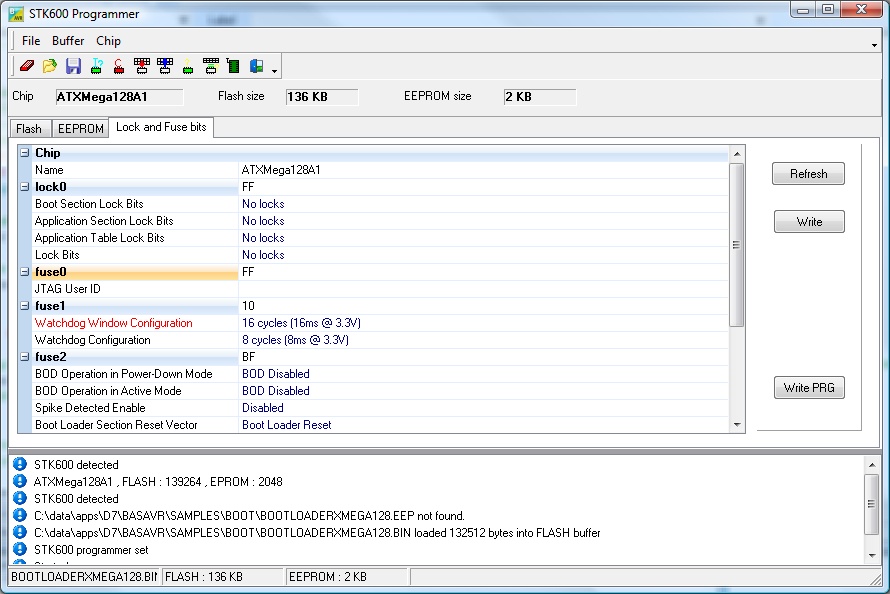

When you select the Lock and Fuse bits, you will get a similar screen:
stk600_3
The XMEGA has one lock byte and 6 fuse byes named FUSE0-FUSE5.
Not all fuse bytes are used. The options depend on the XMEGA chip you use.
In the screen shot from above you can see that under the FUSE1 section, the 'Watchdog Window Configuration' is colored red.
When you change an option and move focus or enter, a change will result in the option to be shown in red.
When you have selected all values you can select the WRITE button to write the lock and fuse bytes.
After this the values will be read again and updated.
