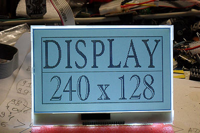

LCD module from Displaytech Ltd. View area 92x53mm, resolution 128x240
Power & levels are 3,3V. Backlight nominal current is 120mA. I use 3,3V with 1,6 Ohm resistor. I wrote 3 libraries for SPI & Parallel modes:
In SPI mode "read from display" not supported by UC1608, so no graphics in this mode (dots, lines, boxes, circles) - only text & pictures. Pictures for this display must be "SED".
